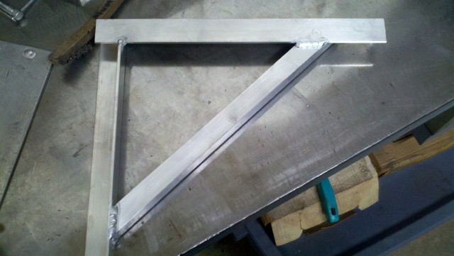

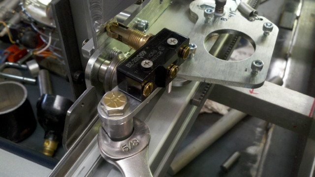

Some updates. Made bracket for the cable carrier. Was kind of flimsy. Added a brace as well.

Here is the brace. Much better.

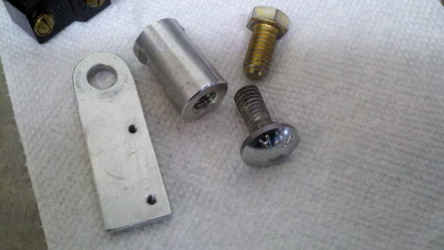

You can use a different Micro switch with a roller on it and it will act like a limit with a trip on both ends and as home too.
The way you mounted the switch on the moving assembly is the way to go. I did the with all 3 axis on my table and if yu are using Mach they can be daisy chained to one input.

OK Tom. You lost me man.acourtjester wrote:You can use a different Micro switch with a roller on it and it will act like a limit with a trip on both ends and as home too.

Here is the way I wired my and it works fine.
Image of the limit and home pins in Mach.
type of switch shown on my Z axis with it's trips.
micro switch BZ-2RQ69 1PA4 there are other with rollers the roller will compress past where the switch trips and not break the switch.

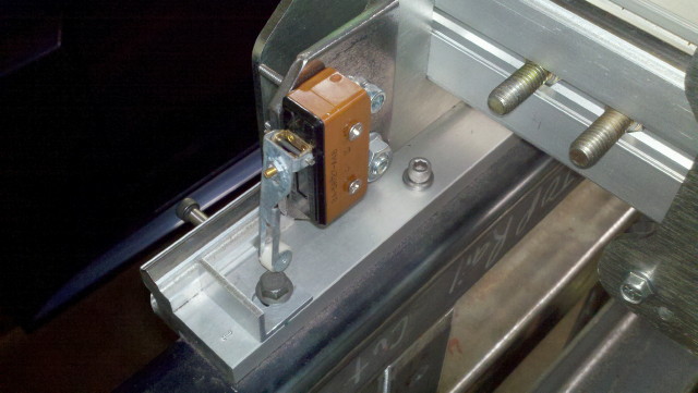

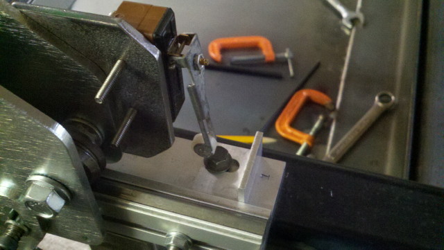

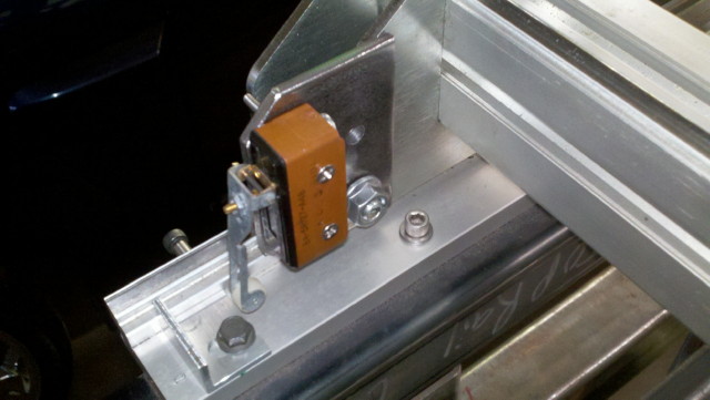

OK. I think this is my 5th design of the X limit switches. I think I finally have it nailed down.
Also made different bracket for the Y stops. Oh and I got the roller style switches too.
This is my X limit set up.

TJ, Where did you source the roller limit switches? Nice fab work btw.
Phil

I put this part number in ebay. BZ-2RQ69 1PA4Capstone wrote:TJ, Where did you source the roller limit switches? Nice fab work btw.
I got them from ebay user equipmatsales I think that is the spelling. They were 10 bucks each.
Thanks.

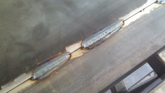

I tig welded the 14 ga sheet to the 3/16" x 3" angle. I got to say what a nightmare. I took my time and jumped around for other areas to let cool. It warped bad now I am trying to combat this issue. I should have just got a shop to bend up some sjeett and I just weld the corners. Oh well. Off to making some stuff to pull it into shape.

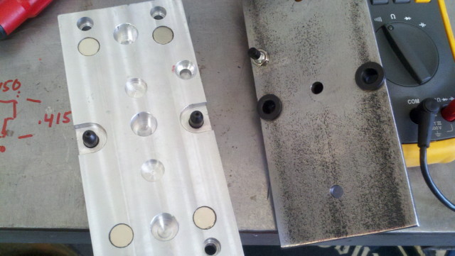

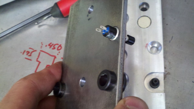

On a better note aside from the warpage I now incorporated a switch to my breakaway set up. I want to wire it in line with the e-stop if that is at all possible. Acourtjester what do you think.
I had to get a little crafty on the mill. You can see the counter bored hole to clear the nut for the momentary pin switch. When the plates are sandwiched the switch circuit is closed. When the plates separate, i.e. torch breaks away the pin extends opening the circuit.
