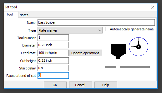

  1. Open the Jet Cutting tool window by clicking Tools>New Jet Cutting Tool
  2. Enter the Jet Tool settings shown below, you will select this tool when using your EasyScriber

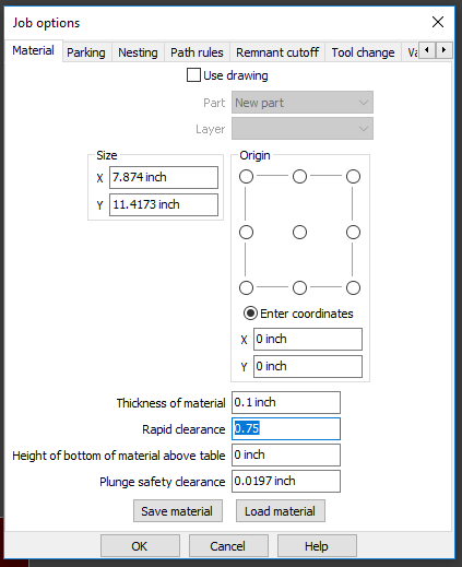

  3. Open the Job Options window by clicking Options>Job Options
  4. Set the Rapid Clearance to 0.75 to force the scribe up between scribe operations

I had called you earlier today (5/19/20) So i am getting it to scribe the problem is I have to reset a new zero after each line.
I have the setting exactly how it is in the screenshot posted here.
How do I get it to stay at the same zero no matter where it picks up and moves to?
using sheetcam and mach3

If compressing the scribe tip .250"-.375" and resetting your Z zero in the DRO doesn't stick you should give your table manufacturer a quick call and ask them as they may have mach3 configured differently on their setup.

I have the Easyscriber but honestly havent used it much. I want to mark cross hairs for drill holes. I have it marking well and retracting between "cuts" but my problem is it is retracting too far in Z. I use sheet cam and generally love it but I'm basically crashing my torch in the positive Z between each move with this scribe. I do have THC turned off. I am using a crossfire pro with firecontrol.
I have the scribe set up with peirce height of .001" and cut height of -.030". Pierce delay is 0s, and I changed my rapid clearance in job options to .25" from 1" and its clearly not recognizing the change on the rapid clearance. Any suggestions to fix this?

Are you able to post a screenshot of your Sheetcam Tool Setup and Job Options screen?
