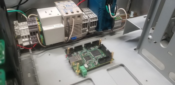

I have a need to make some prototypes on 2'x18" SS 10g cylinders. I'm totally new to cnc so i bought the crossfire to get started. I'll need thc because the cylinders are not perfectly round. I just got the ess and tmc3in1 and my z axis with magnetic breakaway and floating head on order. I'm building my electronics case out of an old computer case. I used some cake pans from Walmart to mount an automotive air filter on the front.

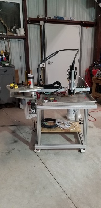

Got the frame made

Re: Diy 18" rotary on a langmuir crossfire 2x2
Wow man loookin good! That Z axis is super sweet but looks like it will crush your gantry if its on the far end!! Beefy!!
Haha yeah. I get about 0.25" deflection at the end of x when i balance it. I'm not too concerned because I'll rarely be out there. My rotary axis will be parallel to the y axis so the defection should be consistent during cutting with the z axis stationary on the x axis. If I'm flat cutting large parts at the end of the x hopefully the thc does it's job. I'm hoping to make some prototypes that are better than my inadequate hand cutting. If the businesses takes off I'll add a supported gantry on linear rails. That's the beauty of 8020 frames.AREA wrote: Mon Jan 27, 2020 10:27 am Wow man loookin good! That Z axis is super sweet but looks like it will crush your gantry if its on the far end!! Beefy!!

Also consider wobble.... (More technically jolt / jerk) which occurs due to axis acceleration and deceleration
Worth a shot I guess... But that is why most plasma cutters run a slaved axis X + X' or Y + Y' to provide axis stability to the gantry when the z axis is moving up and down and the carriage is moving back and forth.
Imo I'd sell the crossfire as a working machine and build one that meets your needs...
Remember the lateral movement with 1g of acceleration will mean that something weighing 5lb will put a force of 5lb laterally.... Or 0.5g of acceleration will put a force of 2.5lb laterally.... Then consider torque / leverage (force X distance)..... 2.5lb X 2 ft = 5ftlb of torque......
Build it light! And it will be able to move fast.... And plasma is all about fast acceleration to maintain constant velocity with changes in direction or blended axis motion

Thanks for the tips. Right now cut quality isn't a concern at all so i can slow it down as needed. I have 0 experience with cnc anything so for 1000 bucks the crossfire gave me a headstart. I do plan on selling it as a kit eventually. I'm about 8k into this project already. I got a quote for a proper gantry xyz steppers and electronics and it was $9800. I'm 2500 into this cncand can probably sell the crossfire for 800. Hopefully it turns into a successful business and i can quit managing a chemistry lab and build servo cncs or laser cutters!

Slowing the cut down is not always a good thing..... Kerf gets wider... THC voltage rises... THC lowers....
What do you intend to cut (roughly) thicknesses plus diameter ?

18" diameter 10g stainless with a PM65.robertspark wrote: Tue Jan 28, 2020 4:44 pm Slowing the cut down is not always a good thing..... Kerf gets wider... THC voltage rises... THC lowers....

I got the z axis mounted and wires soldered up. Also mounted a laptop stand. Working on getting the ess and thc wired up, hopefully today. Quarantine -> progress!
I gave up on the quarantine thing about 6 weeks ago and didn't every weekend having fun at the river and visiting family, but i spent yesterday working on this. I have x y and z Control but i haven't checked to see how accurate the movement is. It works better than i expected with the cantilevered x axis. I still have to wire up there thc and limit switches. After that I'll cut the brackets for the a axis.
