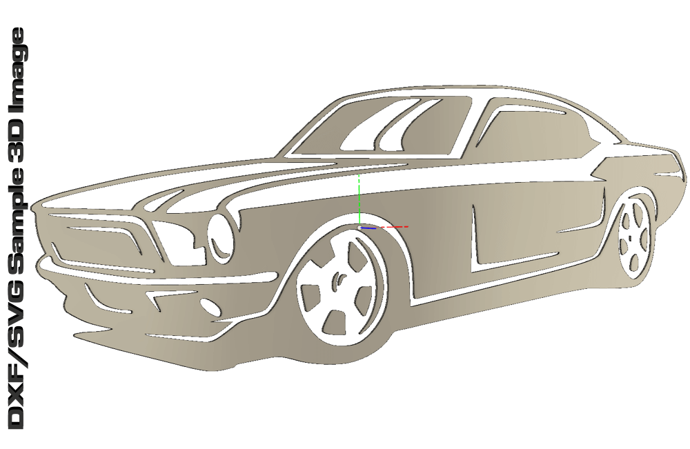

This file needs work, bridging some of the drops.

If you cut that with a plasma cutter, a lot of the detail will drop out. It is a nice file, but it needs some TLC before it is cut ready.

I cut it last week, and thought i sorted it, but the windows came out

Post your edited cut file and I will have a look.beeson1987 wrote: βMon Oct 03, 2022 2:13 am I cut it last week, and thought i sorted it, but the windows came out

"DRIVE the design." Using your eyes, imagine you are looking at a map of the land mass in an ocean. The PURPLE is the land, the BLACK is the water. If you can drive your car from any point to any other point on the LAND without crossing water, then the design is cut ready. If you need to "build a bridge" to get to any point on the design, then you have an "island" which is a part that will fall out of the design, because it is not connected to the rest of the land mass. In this design above, the windshield, the wheel detail and the headlight crescent accent are all islands.beeson1987 wrote: βMon Oct 03, 2022 2:13 am I cut it last week, and thought i sorted it, but the windows came out
