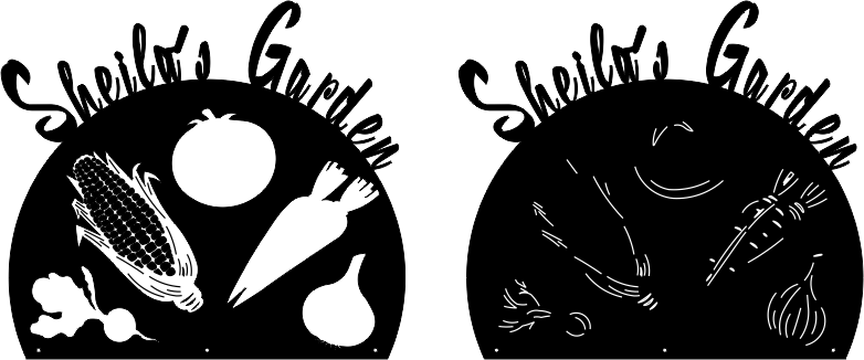

Here's a Garden sign I did for my co-workers wife (same guy I did the 930 Case farm sign for) for a
Christmas present 2 years ago!
Hoping someone could use it for the veggies or a start for their own!
This one is 2 layers, the front piece has drops for the veggies except for the corn which I cut out 1st
to powder coat and glue in later! The others had the lines for details in the back so I could powder coat
it without worrying about overspray! Then when it's glued together the front gives the border to look
right! A little bit of a pain in the a## but better than trying to tape and powder coat each veg!
Then added a angle with square tube and bolt to fasten to a "T" post!

This is all powder coat colors!
That's why i coated the back where just the main color shows thru the front!
I have a 100 or more colors of powders, the border is a "Candy Copper" which
I use for a lot of signs instead of black, it's a "translucent" color so you can add
grind marks that show through and with the "Candy" it reflects light different giving
a great effect!

With experimenting for the last 4-5 years with the Eastwood Dual voltage gun I've been surprised with
some of the results too! You can turn the air down enough to use little "Puffs" of powder (as long as you
keep very little powder in the gun)by hitting the trigger in short burst! I do some Hummingbird signs
around 12" dia. and do 4-7 different colors without to much blending of color! (it's kind of fun to see
what you can do!)
With a 100+ colors of powder you have lots of choices!
For bigger projects I use my EZ50 gun, a lot more versatile!
