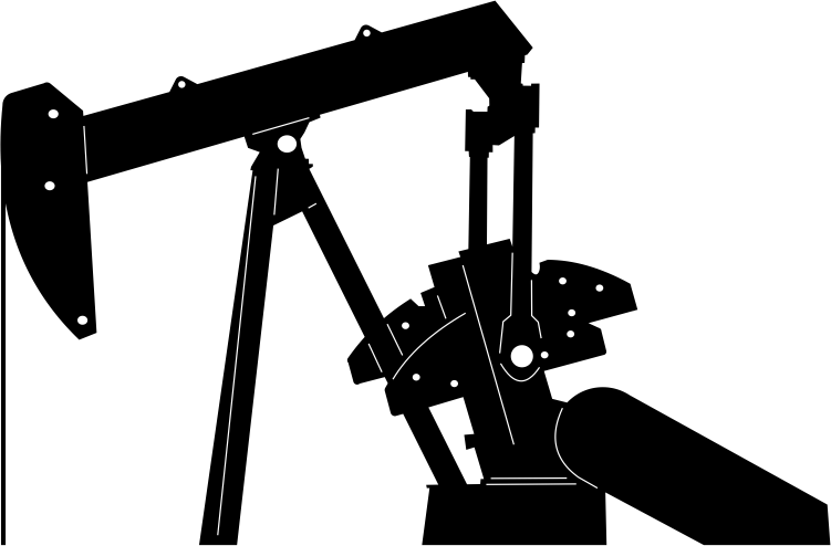

Nothing fancy but a quick draw of a fracking oil pump that I needed...might as well share it. Add it to your library, you never know :Like

Nice looking clean file!! Thanks for sharing your design. My only concern is with the long narrow rod. Even if cut at 48" wide, this is still only 1/4" wide and might be subject to damage or bending. But I suppose if the entire piece is mounted to a backer, it would be fine.

That's a well pump for extraction.
Fracking pumps water & chemicals & sand down the well at very high pressure.

He lost me when he put a "K" after the "C", what David speaks of is called the bridal, it is made of cable so it flex's as it goes around the horses head creating the up / down action which is tied to the pump deep in the formation (some are more than a mile deep) by sucker rods. This device is called the "Pumping Unit". The adjustable counter weights on he right side of the pic is for offsetting the string weight of rods.
The "Frac" (no K) took place after the well was drilled during the completion phase with a high pressure fluid / sand and / or hi tech polymer combo that is injected in at very high pressure with several semi truck / trailer mounted units. When the manifolds on those Detroit's turn cherry red you know the formation is coming apart at the seams. The purpose of the sand and / or polymers is to keep those cracks open.

"Pump Jack" is what you have there.
couldn't recall the name, we have them around here as well, mainly to remove brine from gas wells,
however Pennsylvania does have plenty of oil wells.
