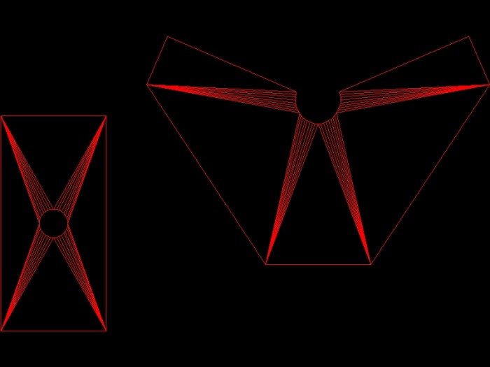

Anyone know how to figure this out....
I need a cone. The top of the cone is actually a rectangle that is 14.75" x 30.25". The bottom of the cone is a circle, 4".
Overall vertical height is 14.75", how would I figure this out. I am not a true CAD guy so this is a little beyond me. I need to figure out how to cut it in 4 pieces. It will be cut from aluminum. Is there software I should be using? Heating duct work software maybe?
ou812
Posts: 190
Location: Knoxville Tn.
Re: need help making a cone....
Post by ou812 »
rpage

wow thanks a ton!!
