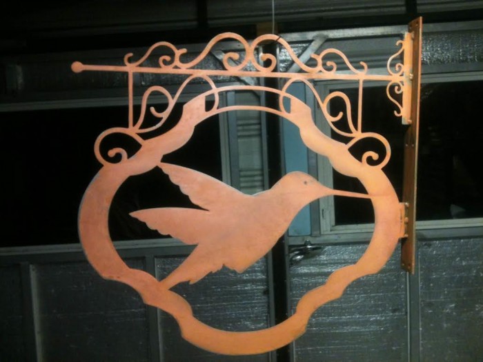

This one was a lot of work to draw edit but its what my mom requested

I would program the little stiffener on the bottom in it before you cut I added it after I was done as it was a little flimsy,
cut out of 1/8 steel

Very Nice, Looks great, Thanks for the file!!

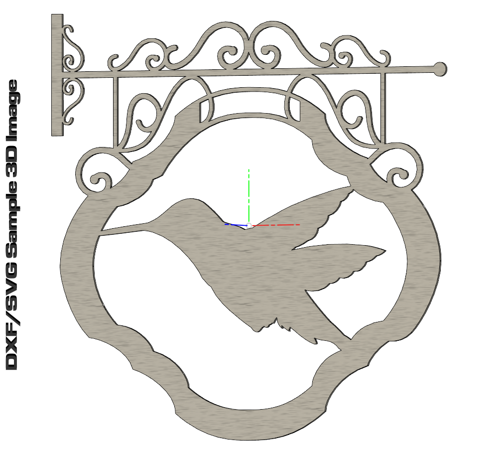

Is it just my software, or is this file made-up of a bunch of overlapping/unconnected two node segments?
This is not just a comment. I am actually trying to figure it out. I'm not sure if my software did some strange import or what. I do not see any segment more than 2 nodes long in this file. Every node I see is actually two nodes on top of each other.

Could someone please open this file and let me know if you get the same result I did?

Your right, I brought it into CorelDRAW X5 and yes it was lots of segments, you come across that a bit on some files from here, not sure where it's program specific or method being used. I know Tom was having this happen early on when he was drawing in Draftsight
I tried to join curves in Corel but some of the intersections went crazy so I noted which ones they were, joined them manually and then use the join curves function to join everything up. I think I have it all.

Thank you very much Muzza.
I just installed the new pre-release version of Inkscape and wanted to make sure it was not causing this problem.
