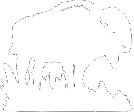

Hope these help.

I can not believe this, 70 dxf downloads and 39 pcm downloads and not one thank you for sharing!

Hi Metalart!
I didn't download but I will certainly say thank you! :( I had a question, when I open the dxf it is a large circle with the image of the buffalo in the upper right quadrant. Was there a reason for the circle? I am new to this and my BobCAD software should be arriving any day but that is how it opens in CorelDRAW. Just curious.
Thanks again.

Thank you Metalart.....Charlene, if you look closely you will see a a gap in the circle where it intercepts the detail on the Buffalo. The software is trying to close the gap in the detail....crazy I know....but if you think about it, its helpful in spotting and closing any open portions.

arcs like that occur when the arc start and end angles get swapped in the dxf (for whatever reason), arcs extend counter clockwise from start to end angle, reverse the angles and you get the entire unwanted part of the arc, which can extend way off the screen if the radius is large
