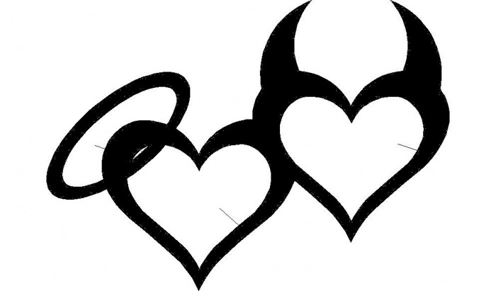

I'm having trouble getting the part on the left converted to a cut path. When I try it distorts so we have been unable to cut it. Wanted to see if anyone on here might be able to help. They can use the file as well. Any help is greatly appreciated.

It won't let me load the .pcm here it is in dxf. If anyone can get this converted to a cutpath in a pcm please email it to me. mturner719@yahoo.com

Your problem is the ring on the left is still connected where the ring meets the heart. You don't have a closed path on the inside of the ring. You need to cut that line out, but first you'll have to edit it so it connects completely. Then just cut it usinh the "T" function. Hope that makes sence! Just zoom in on that area and you'll see the problem.

Bob is correct. All I did is remove that segment where the halo meets the heart and it cut perfect.
