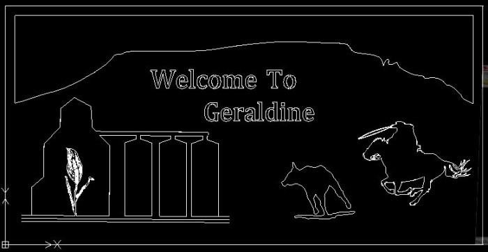

this pic was given to me with the black to be cut
i have done this to dxf and am trying to work out the detaile on the horce in this pick if anyone has ideas please help the horce is to be cut so stuff will fall out
The way the 2nd pic is now everything will fall out (horse, cow top clouds). It will cut all around the horse than it will fall out. Is that what ou want? If so you will need to work on your letters such as the O's E's. If you don't connect those the center will fall out and mess the pic up.
