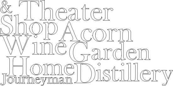

Procrastanation on Learning my new tm system has finally bit me in the ass. I need to cut sone letters and have them primed for Monday morning. My problem is I have imported a dxf of what I need to part to be in tm cad but am un sure of the tool pathing and the nesting. Have managed to make the male and female paths but it just does t look right and I don't see my lead ins. Nor can I find the option to nest the parts there is 100 letters to squeeze into a 4*8 sheet. If some one could help I'd gladly pay for your time since it's a paying job for me.

Hi,
PM me the original dxf without tool paths and I will give it a shot for you.
I have been working with my TM3 for about 3 years.
Mike
Mike

Re: Help with dxf to tm cad
heres the dxf hope it works
Hi,
Here is a nested cutpath. I hope it works for you.
Mike
Mike
