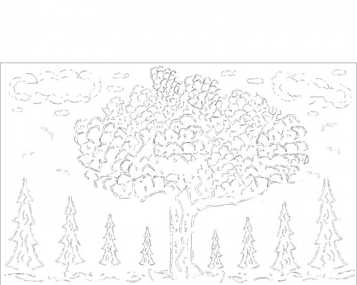

Hello everyone,
I was given the task of making a scenery to cover some garbage container, another large project.
This is the file, to be honest I am not an artist.
Any imput would be greatly appreciated
This is an 5'x8' size plate

this still needs alot of werk, but heres a little help

Streetwerkz wrote:this still needs alot of werk, but heres a little help
The file is smaller, could you tell me what you did?

cleaned up the lines, reduced the nodes.
basically the same picture, went from 130,000+ segments down to around 25,000 ish.
this will make it a ton easier to werk on & a lot faster for your machine to cut.
additionally (in my opinion) this usually makes the cuts look nicer

What kind of software do you use to clean the file,
I always have this problem, I use Autocad Mechanical, and have no idea on how to clean it.

PLT file, working good

Sorry I missed your question.
I use EnRoute mostly for clean up, followed up with Bobcad
Panels look great!
