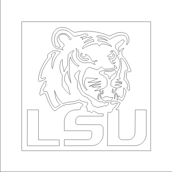

I got this file on another site and i am gonna use it for a table top. The problem is when i open it in sheetcam It says cant
offset open paths but i cant see any broken lines in delta cad. Can someone take a look at it and see what i am missing? Thanks

Hi, Only one line was not connected so should work now? I think you also need to attach the letters to the inside of the frame so you don't loose the whole picture.

Thanks, that fixed it. Yeah i am gonna get rid of the inner square and put a backing piece under it to make the tiger pop out with color.
