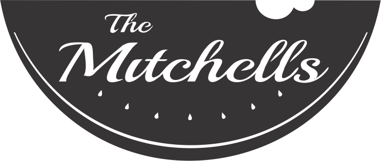

Hello everyone,
I am grossly new to plasma cutting. I have started doing artwork for signs and other metal cut outs using AutoCAD LT. I am a novice, but a little familiar with the basics of CAD. I have been having issues with drawings lagging or freezing our computer while trying to load drawings into our plasma cutting software "fabrication CAMduct"? The file is 12.6MB, is there a way to condense it or simplify the file prior to loading it into the CAMduct? I would appreciate the assist GREATLY!!!

Re: New and need help! please
Ok! so i searched how to cut down on file size! now i have the apostrophe and the S screwy!
this is the file that was freezing the program. I got it from 12MB to 10MB and zipped it. Can someone help me determine what can be done to the drawing to make it work?
I tried opening it and if I highlight one area, all of it highlights. Some of my programs won't even open it. Maybe multiple layers???
I would think a redraw is necessary.
It all looks usable to me.
Your Covington Pub file looks great, I suppose if you see a couple an issue with the S just fix that and then cut it.
The watermelon file had thousands of nodes which was making your file size enormous and did need some work but def a good file that can be worked with.
I was able to get your node count down to less than 300 and file size down to a tiny 384KB without distorting the profiles much. Have a look at the attached dxf and see what you think.
