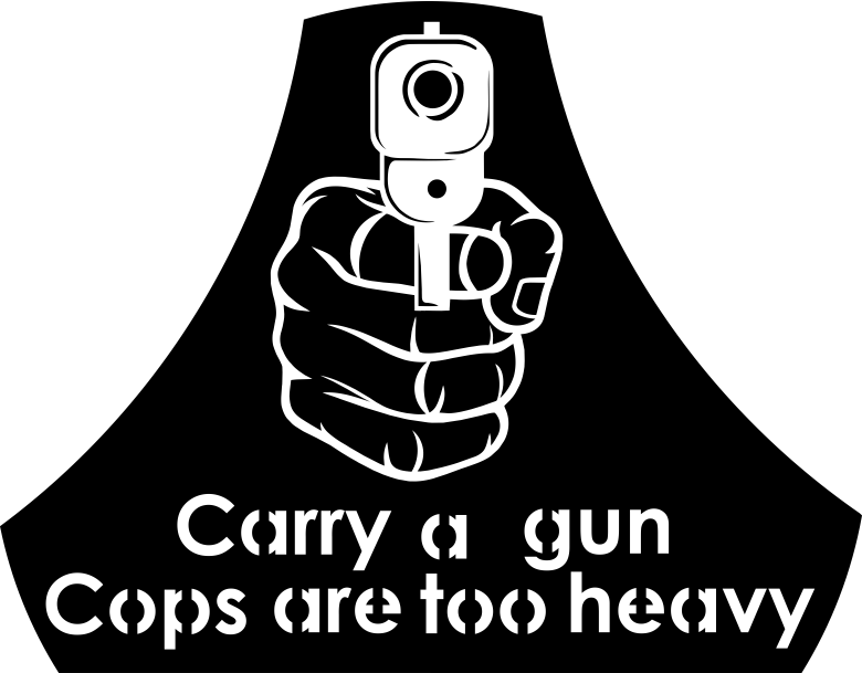

I saw this on a pawn shop sign and just had to design it. my software says its cuttable. The pistol is cut separately and is an overlay

Your software is WRONG! It is not cuttable as drawn. You have ISLANDS that need to be fixed!

Here is your design. The blue is WATER. The green is LAND.
"Drive the design."
Place your cursor anywhere on the land, and then move around your design. If there is any land on the design that you cannot get to WITHOUT crossing over water, then you have created an ISLAND, and that part of the design will fall out when it is cut.

He mentions "The pistol is cut separately and is an overlay"
Looks like it would work to me!
Posts: 2609
Re: carry a gun
harrymorley wrote: Sun Jan 15, 2023 2:25 pm I saw this on a pawn shop sign and just had to design it. my software says its cuttable. The pistol is cut separately and is an overlay
You should have shown the pistol overlay somewhere in the drawing. Which parts of the pistol are in the second layer???

Looks good Harry, i only found 2 spots around the barrel that i need to adjust to cut at that size. I was about to cut it a tad smaller.

I guess Joe didn't bother to read the original post. Harry said " The pistol is cut separately and is an overlay". I hadn't even read Joe's posts, but I thought I would show it as separate pieces so others could see what the pieces look like. Here is the file.

in answer to all the debate..the post was NOT modified after originally posted . It included the line that the pistol was an overlay . Just FYI

Okay Harry! I missed it then. If the hand and gun are a layer, then the file looks great.

Things are calm, David. I evidently missed, or did not read the OP's comment about doing an overlay. I responded as if the original design were to be cut out of a single piece of metal. The OP stated that the overlay clause was in the original post, and I admitted several times that I could be wrong.
I do not know what experience the OP has, and given the price of steel, I did not want him to waste material trying to cut this out of a single sheet, which is what would have happened. He drew two layers as one, and that caused a bit of confusion. That is all there is to it.
