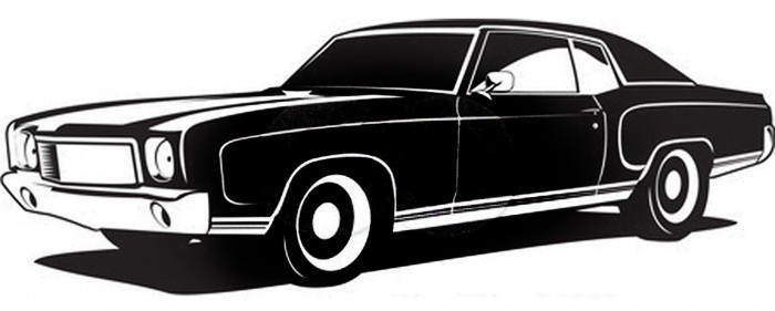

Monte Carlo Design
Post by 34chev »
Need help converting this to DXF. Just the outlines. Thanks in advance

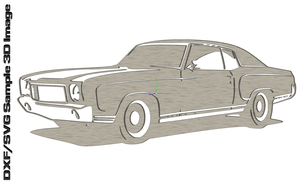

Here you go.
Monte Carolo.dxf

Nice job, thanks! Looks like the 72 Monte Carlo I had.

excellent work

Amazing job. Love the stance!

I didn't have this one. Thanks for digging it out.
Looks like the wheel hubs will need some bridging so that the double round centers do not fall out, leaving a larger hole, and losing some detail.
Minor fix. And as typical with most auto traces, there are some stray double drop outs that will need to be addressed to keep the the torch from diving looking for material to cut that will have already dropped out. rear quarter panel trim, mirror,front turn signal lights at bumper and a few other minor spots. All relatively easy fixes however.

Maybe something like this.
Monte Carlo.dxf

I saw the drops after posting and put of the bridging until today so you beat me to it David! Looks great thank you!

Nice work David! I willl update my file.
