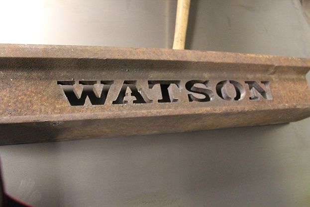

Robert, I have a PM45 with machine torch and it has no problem cutting 3/8", I have even cut a name into the web on a piece of railway line which was 5/8" and that came out fine too.

If you are planning to machine cut (vs hand cutting) the Powermax45 is conservatively rated for 1/2".....meaning if your machine has a height control it will pierce 1/2" without affecting consumable parts life. I am attaching a picture of 1/2" cut with my Powermax45 on a cnc machine.
Compressor. The 45 will cut with any compressor that can supply air at more than 90 psi while air is flowing at the torch. If the compressor is rated at 6.0 cfm @90 psi or more.....it will keep up with the plasma. If it is rated at less than 6.0 cfm, the pressure will eventually drop below 90 psi, the Powermax45 will sense low pressure and will shut off the arc. A larger compressor tank will allow more time between compressor cycles, but has no effect on the ability of the compressor to keep up with the plasma demand.
When my 45 is used in my shop it runs with a 12.8cfm compressor with an 80 gallon tank. I can cut continously and the compressor comes on every couple of minutes and runs for about 30 seconds. When I used my 45 outside my shop I often use a small Porter Cable nail gun compressor rated at about 2.8cfm and with a 3 gallon air tank. I get about 20 to 30 seconds of cut...then have to wait for the pressure to build back up before I can cut again.
