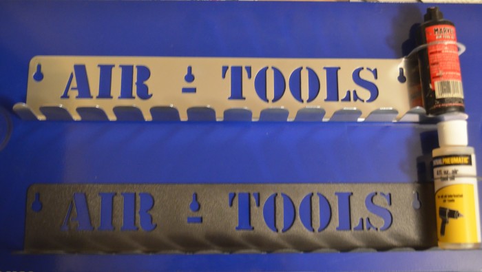

Air Tool Racks as I do them, also has a spot for the never present Air Tool Oil.
I powdercoat them in a single stage "Chrome" which is really just a silver not a two stage Chrome look.
I also do some in Black Wrinkle... The two end holes are 16" on center to fit stud C2C width.
I bend them in the sheet metal brake so there are no slots...
I also have a Visegrip rack that hangs them from the adjusting screw instead of the jaws.
ETA I make them from 18 ga sheet, works fine but I don't have the weakening brakeless bend slots.

I like the oil bottle inclusion. Thanks for the file.

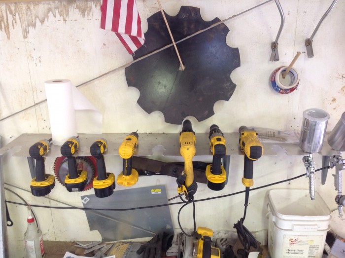

Here is a cordless tool holder. Ya'll probably have a cleaner shop so ignore the mess!
Thanks for all the cool ideas!
