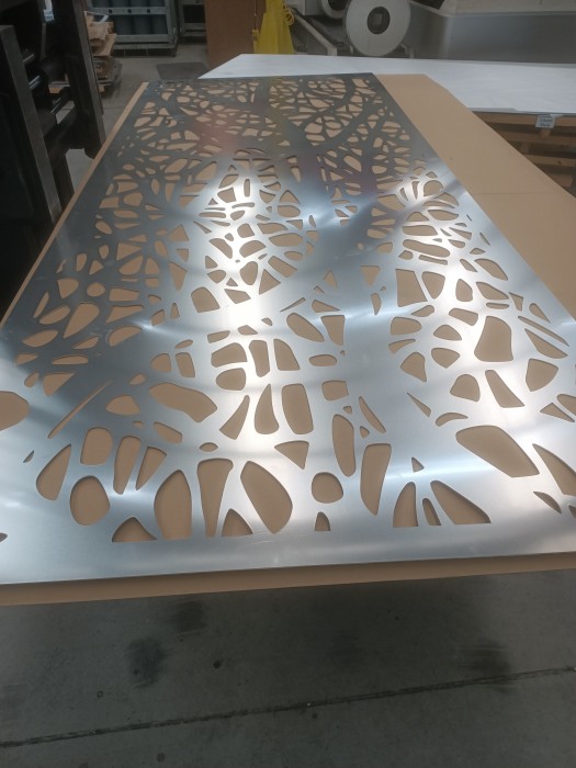

I ended up going over the whole thing and converting to arcs then the client changed their minds awesome love my job sometimes
Any way here is the one I actually cut along with a photo.
Screen-Vine-1170x2980.dxf
Maple-Screen-1170x2980.dxf
Posts: 11441
Re: Conversion Help
Nice work!! I think I still like this one better. But they say "the customer is always right".

Posts: 2926
Re: Conversion Help
I like the vine panel better myself, a little more modern loooking. Pretty cool, thanks for sharing your final design!
