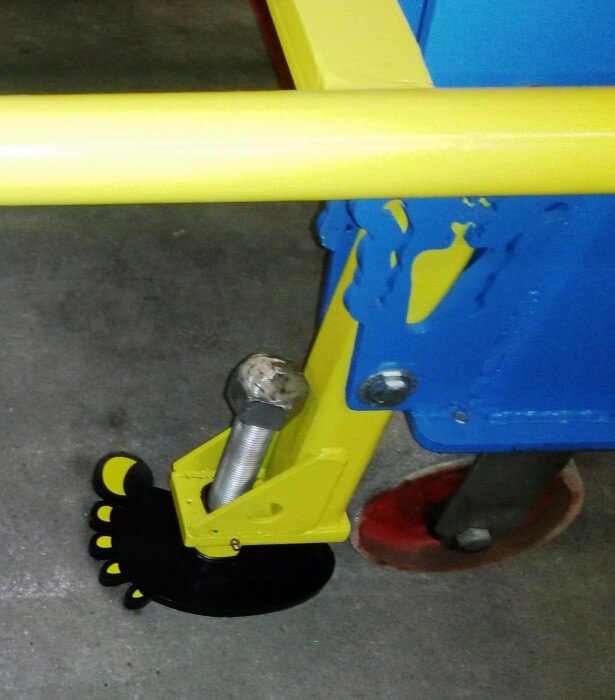

Here you go, the feet & toenails were created in CorelDraw 16 but saved in the CMX format so all versions of CorelDraw could open the file. I used vinyl for the toenails, Let me know if they are any problems or questions out there:

I cut the feet out of 1/2" plate and welded a short section of pipe on them for the adjustment bolt to go into. The pipe pocket has a washer made of 1/4" UHMW plastic in them for ease of turning on the bolt. The legs were constructed of 2-1/2" x 1/4" square tubing, 3/4" HR base plate to weld the nut too and 1/4" HR for the gussets. The bolts used were well head bolts (oil field trash here ) If you zoom in on the first photo you will see a grease zerk for lube.
