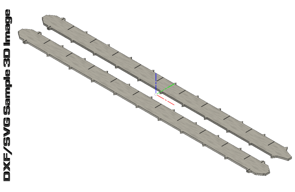

;) here you go
samsongrate.dxf

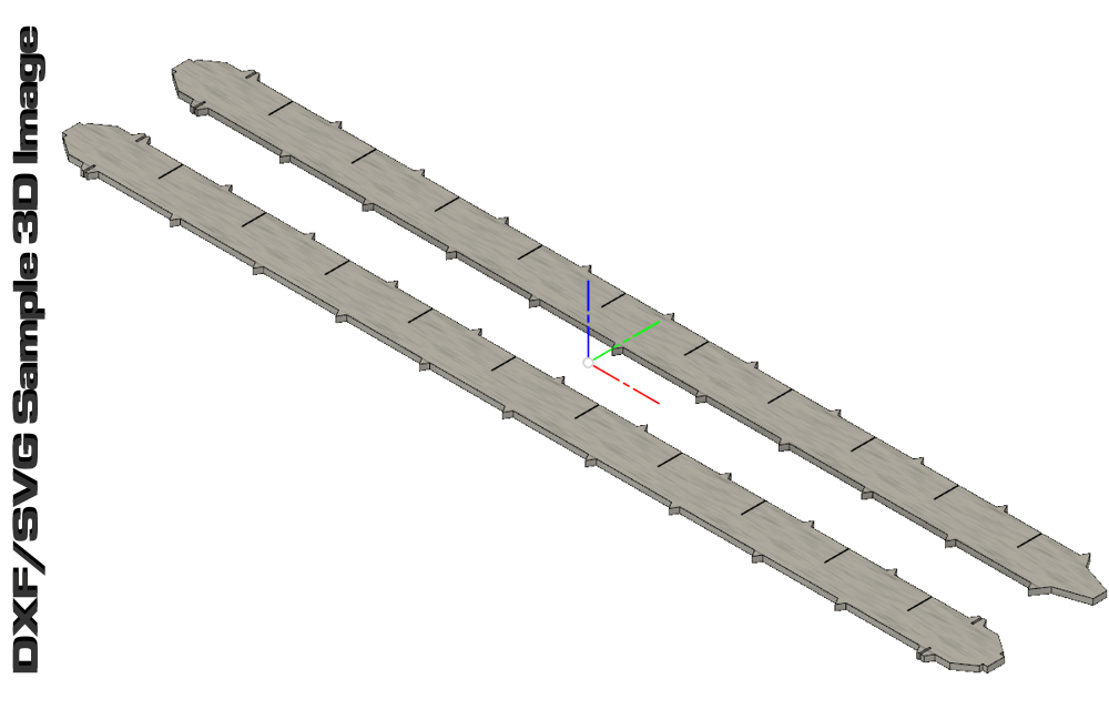

SamsonGrate311.pcm
SamsonGrate311(1).dxf

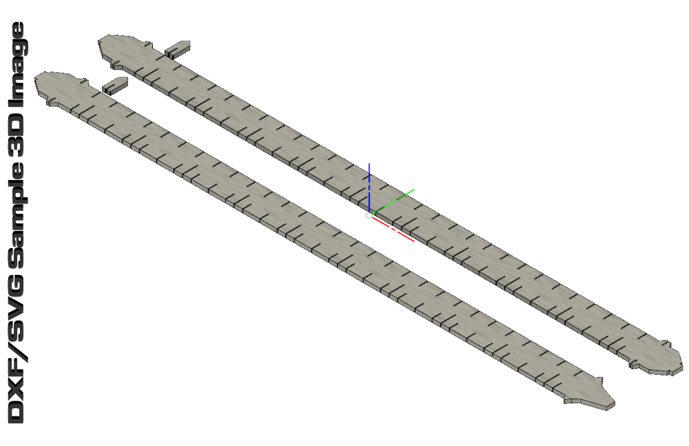

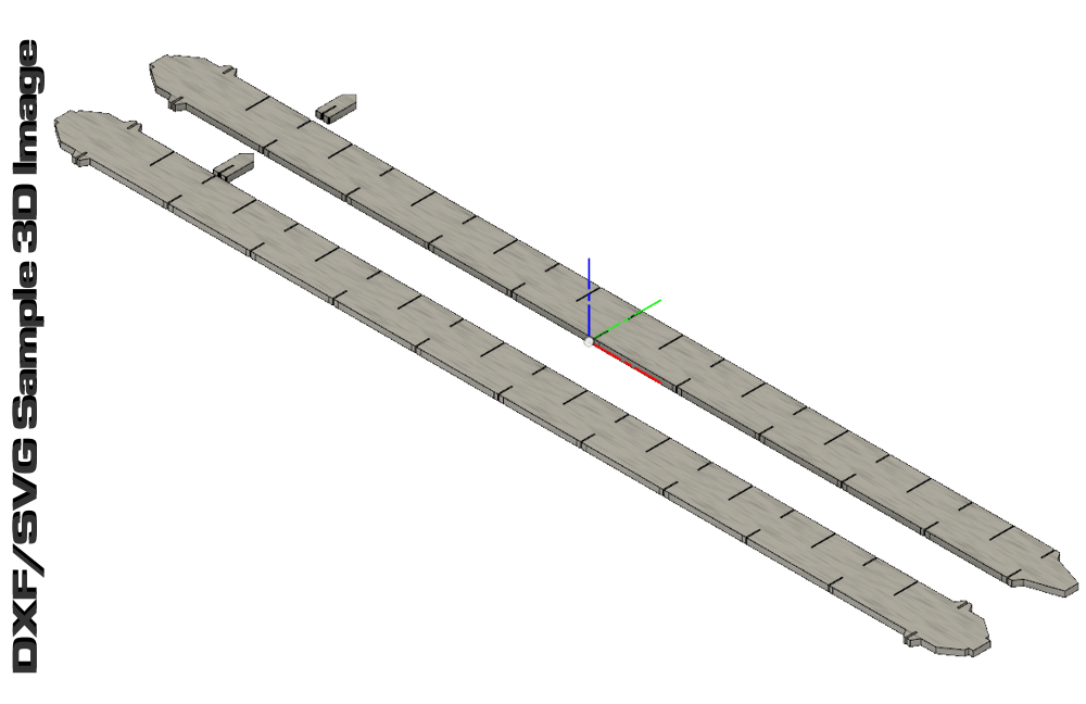

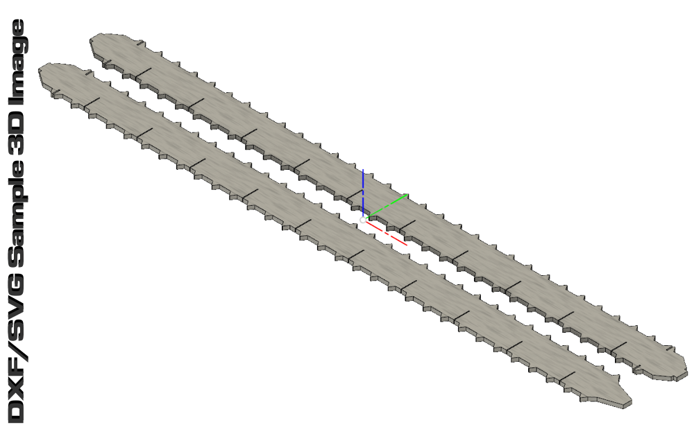

Post by Joe Jones »
Four options. Easily modified for a 4x4 table too. Individually replaceable grate points :mrgreen:
Joe
SamsonOriginalGrates.dxf
SamsonEnhancedGrate.dxf
SamsonOriginalGratesPoints.dxf
SamsonEnhancedGratesPoints.dxf

Awesome selection to choose from in the topic. I think I will do the replaceable points version Joe posted. Thanks guys :Like :Like

I drew that one because it made sense. If the small tabs at the ends of the grates slip into a slot to align the material with the edge of the cutting area, why can't the individual points be replaceable as well? :mrgreen:
I have not CUT these grates to test them, so the drawing is simply a modification of the original PlasmaCam files. I don't see why they would not work though.
