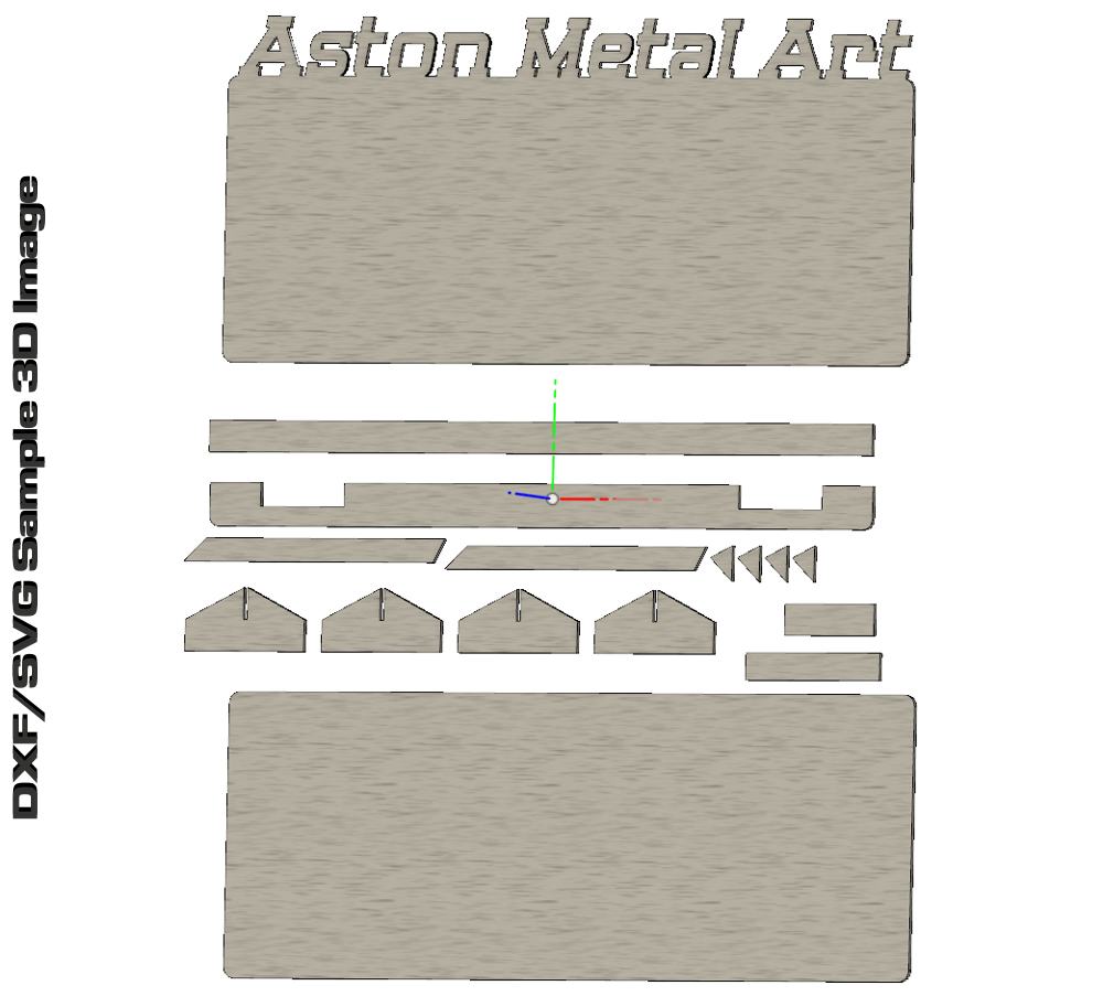

its in plasma cam format but heres one i drew up to move plate the triangle brackets go on the bottom and designed for 2" square tubing this is what i use for forks to move plate around with my tractor mabey someone can convert it to dxf

otisa2007 wrote:its in plasma cam format but heres one i drew up to move plate the triangle brackets go on the bottom and designed for 2" square tubing this is what i use for forks to move plate around with my tractor mabey someone can convert it to dxf
quick attach new plasma spider.pcm
The side pieces have different angles. Which is top? I don't understand what the triangles are supposed to do. And what are the pieces that look like a house?
