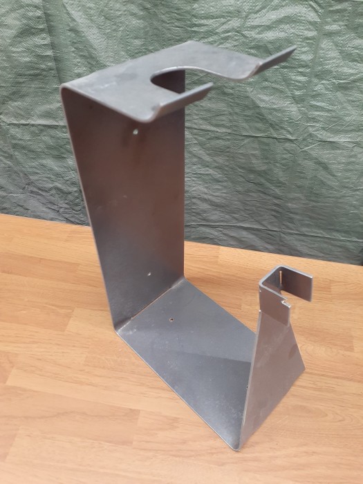

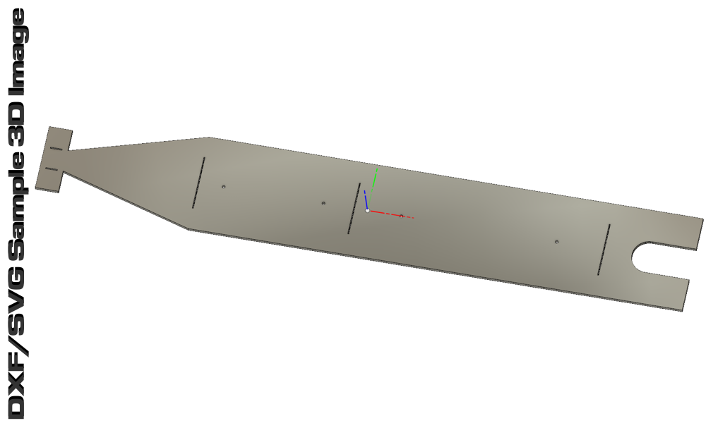

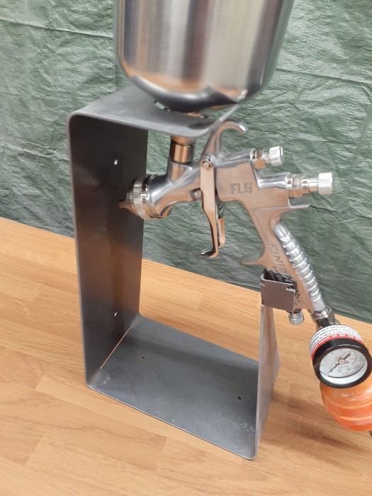

Can't make it into town to buy one, and need it today for a paint job, so I made this one out of 14 gauge scrap. Not entirely happy with it since it seems like the back piece needs to be a little stiffer, but it does work fine even with full paint cup. Maybe I'll revisit the design later. Anyways here's what I came up with this morning.
paint_gun_stand.CDR
paint_gun_stand.dxf
Posts: 2927
Re: Gravity paint gun stand DXF design
That's pretty awesome Scratch, thanks for sharing, this will definitely come in handy :Like :Like

Just cut it and it works fine, thanks for the file!
