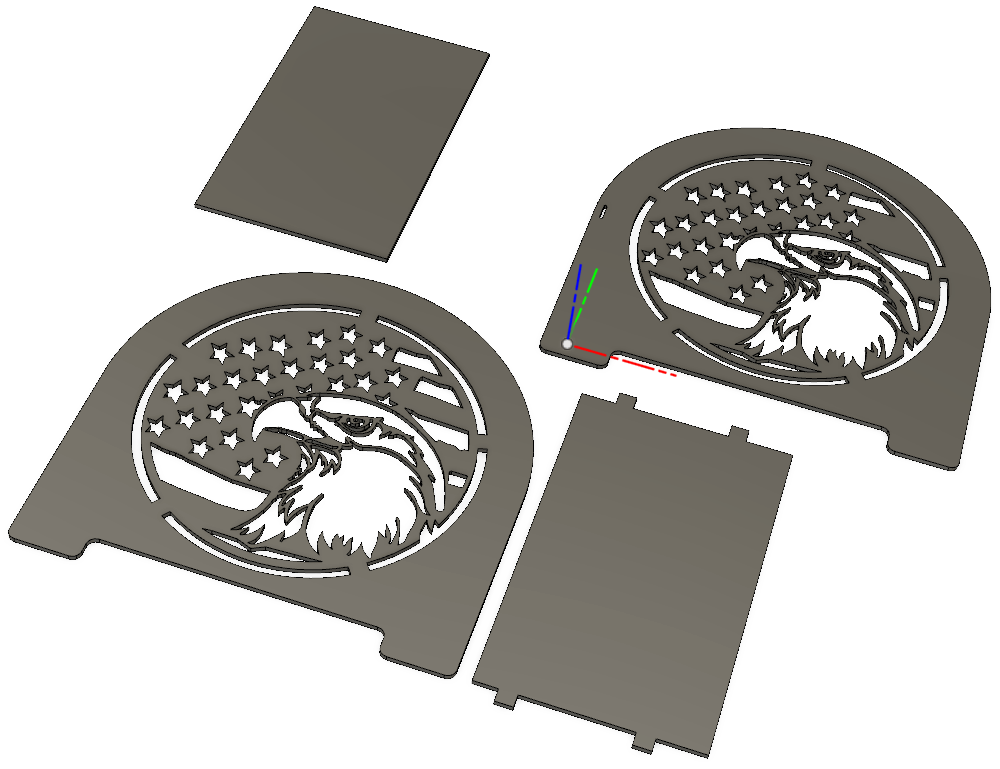

Hey guys I'm working on a collapsible fire pit I have a photo right now I'll share the completed file with I'm done with it I've done more work to it since I took this photo. My question is I'm wanting it to fit on a 4x4 sheet any help would be great. Currently the image show is 24x24.Thanks Willdamit

What exactly do you want to do with this file? I see tabs on one plate, but no slots for it. I see no hangers to hold them into place. The bottom plate is just a rectangle...
You need two sides and a bottom.
Joe
This is my edit on your design. Do as you wish.
JJ - eagle flag firepit.dxf

Thanks you will have to do a YouTube video on how you did this. Thank you so much. I was trying to do a tab and slot

Here it is with just the blank pit.
So you could easily add any design without deleting anything
I fits neatly in a 4'x4'sheet
Slots are 1/4", so I would either draw them bigger if you want 1/4" plate or drop the material thickness to 7 gauge (aka 3/16" plate).
I like the design.
Joe did all of the heavy lifting on the notches and clean-up.
